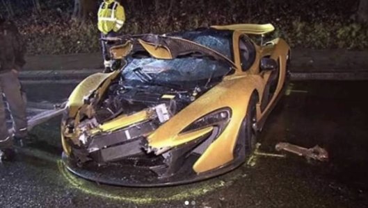

Whist the above cars may look bad, as long as the Tubs are not damaged they will repair back to as new. They are designed to Just " Scrunch" up at the front in the event of a accident.

All Macs have 2 front subframes one either side of the the Tub, these bolt directly on to the Tub. In the event of a front impact these are designed to crumble to keep the impact away from the passenger cell. Everything in front on these sub frames, rads, ac units, wings, etc is also designed to crumble. Every single damaged part will be replaced and either glue or bolt back on, just like parts from an Airfix model. Works driver Tim Mullen put his 650 GT3 into the wall at SPA at 135, he walked away. Despite massive impact and damage, as the TUB was not damaged car was easily rebuilt. Have seen lots of what looks like very badly damaged Macs including P1s being repaired at local body shop, over the years.F00316FE-0FA0-4F96-A5DF-D3784EA779B7.jpeg
