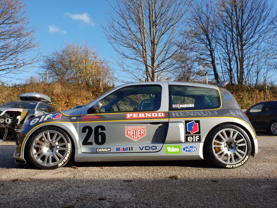

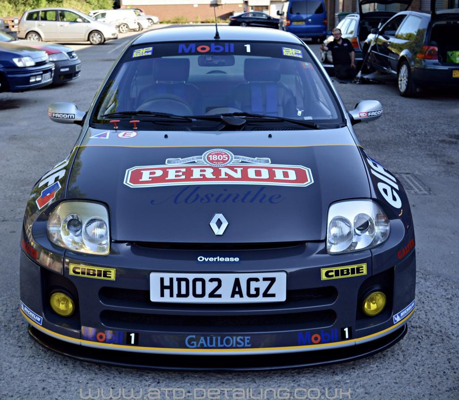

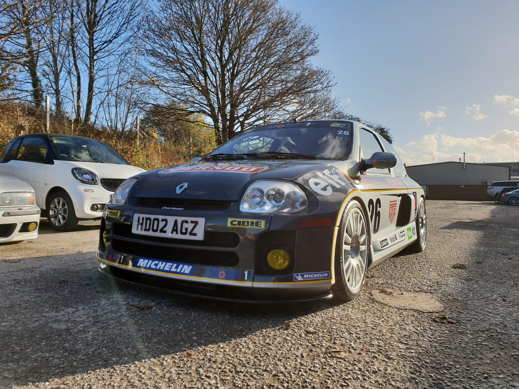

Thank you,
What's been done to it..

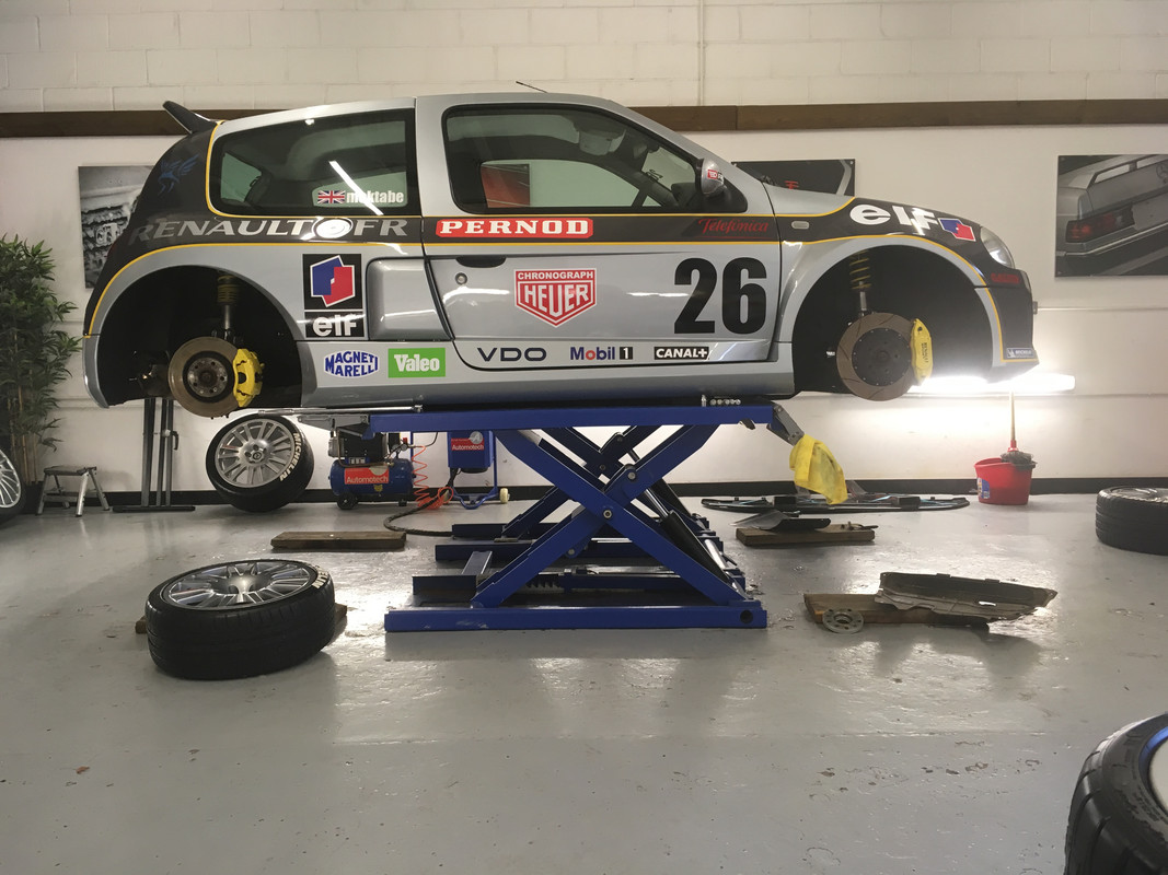

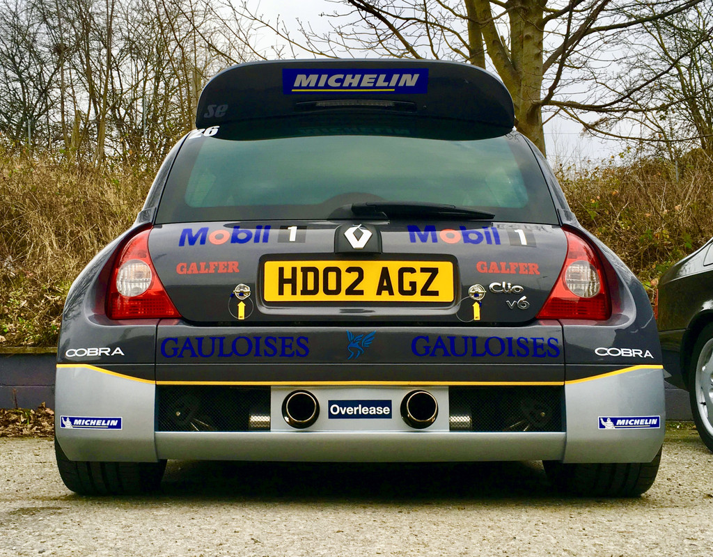

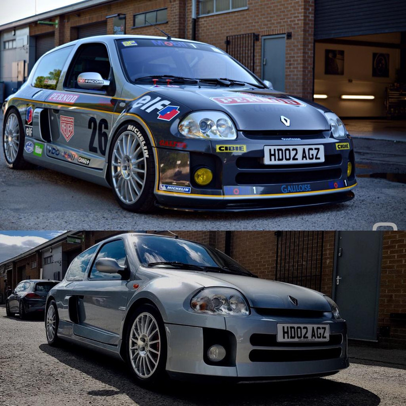

KW V3 coilovers with spherical top mounts,
Sparco steering wheel trimmed in grey alcantara ( original is like a bus steering wheel ),

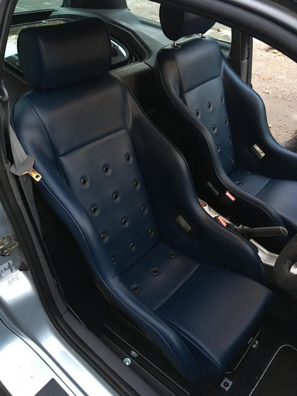

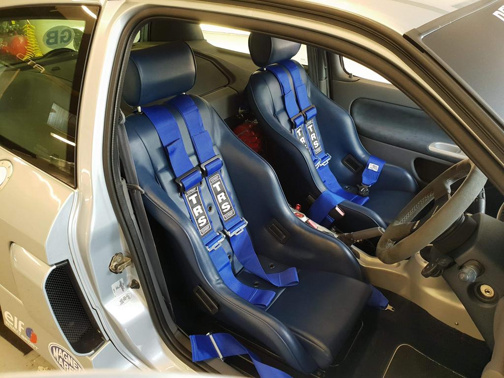

Cobra RSR seats custom made in dark blue and TRS harnesses,
2 piece brake discs,
V6 Trophy front splitter, replica as originals are impossible to find,
V6 Trophy rear spoiler, again replica,
Quicksilver back box,

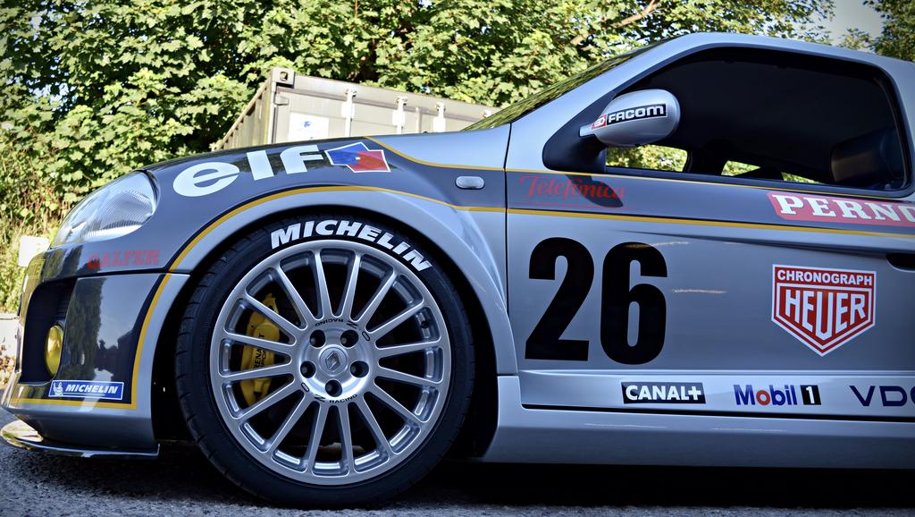

Cromodora mag alloy wheels,
Plumbed in fire extinguisher,
Clear engine cover,

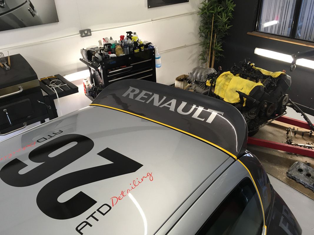

Straight after buying the car it had a 2 week holiday at a V6 specialist in sunny Wiltshire for a general once over. He changed the cambelt and whist the engine was out it had a new water pump, clutch and other little sundries that are a PITA to do with the engine in situ.

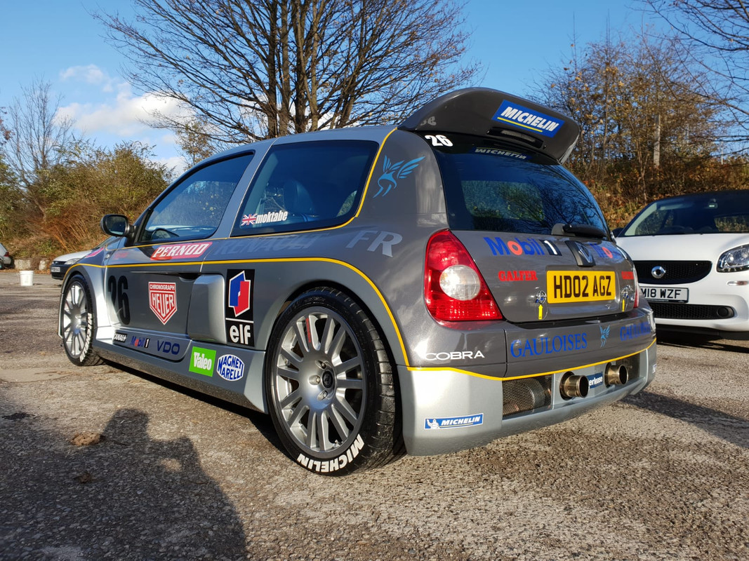

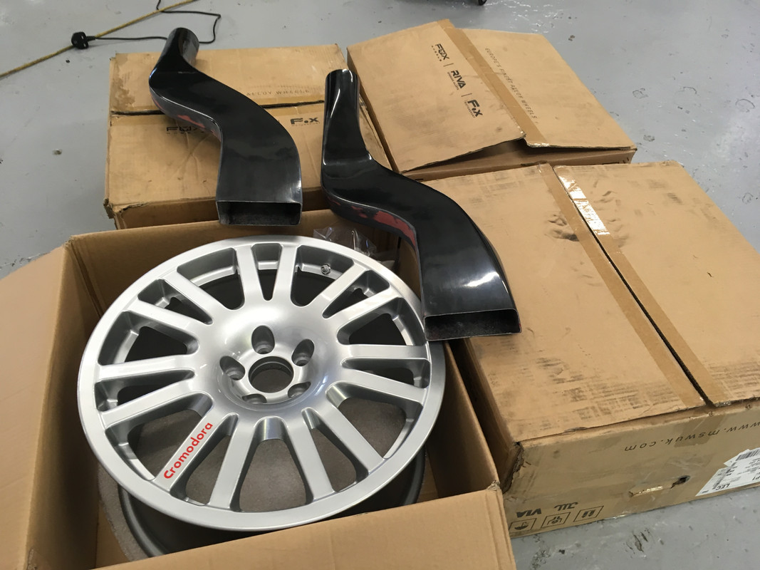

Originally managed to find a set of BNIB Ph2 wheels, same OZ wheels as the Ph1 but 18" rather than 17" and was more than happy with them. An opportunity arose to get a set of the Cromodora mag wheels and that wasn't going to be turned down! Rumour has it that for each V6 Trophy Renault made 5 sets of Cromodora wheels were ordered and that was it so, not too many sets about. Also managed to find a set of replica V6 Trophy brake cooling ducts along with the wheels but unfortunately the road car is a bit different to the race car! Various things in the way on the road going version. Ended up fitting the inlet part only ( purely as I like the look of them ).
With the suspension changes the handling has been transformed from a wallowy thing into something that now goes where you point it...in the dry anyhow. The dry grip is unreal, it helps as the Cromodoras are 9" wide on the rear and 8" on the front which on a French shopping trolley is insane. The seats sit lower than the oem ones which sat you way too high.
There are still a couple of things I'd like to do but whether they get done or not is as yet undecided. Maybe a pair of branched manifolds and a pair of sport cats to replace the pig iron manifolds and the 4 cats the car currently has. Also maybe a Ph2 gearbox as they have better ratios.
